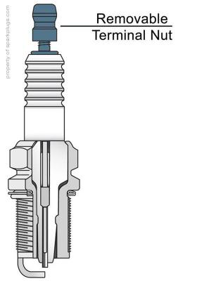

uman1030 Posted March 18, 2014 Report Share Posted March 18, 2014 Sparkplug tips are tight? Quote Link to comment Share on other sites More sharing options...
