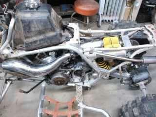

LA98SHEE Posted December 17, 2013 Report Share Posted December 17, 2013 I recently purchased a used banshee my second one I made the huge mistake of selling the first one and this one had fmf pipes and was jetted to run without the airbox lid and factory filter How far off should it be when I switch over to dual K&N and run the CFM aluminum air box? since my stock one is busted up Quote Link to comment Share on other sites More sharing options...
