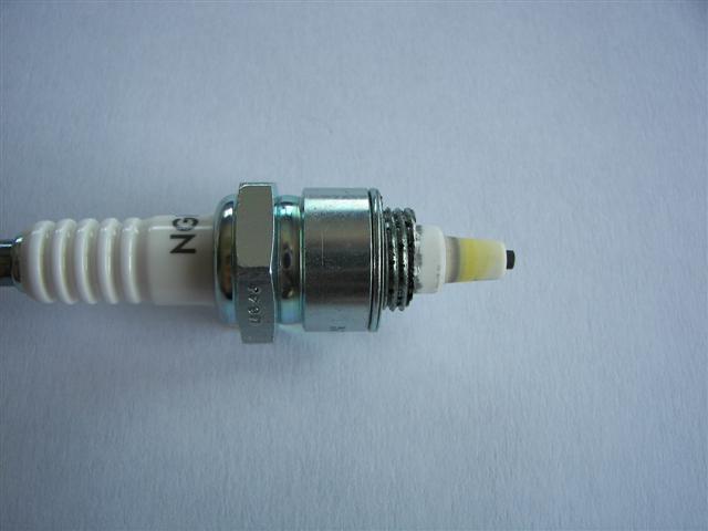

peak-j Posted October 7, 2013 Report Posted October 7, 2013 Ok, i did a plug chop and here is what i got. Toomey 2-1 air filter no box, i was told just the reed petals were changed out. Everything else on the engine is completely stock down to the pipes, carbs synced. Warmed up to temp, put new plugs in, ran it full throttle up to 6th gear for about 5 seconds and ran out of room. Clutched it, killed engine, removed plugs and put old ones back in. Has 240 mains right now, 3rd clip. Let me know what you think. Thanks Sent from my Motorola Electrify using Tapatalk 2 Quote
Tedder Posted October 7, 2013 Report Posted October 7, 2013 You're pretty lean. This is what you want. The ring is actually shade darker than the picture looks. Don't pay any attention to the yellow tint. Thats an oxygenated fuel characteristic. Keep in mind that plug chops (done correctly) focus on the main circuit. Quote
trickedcarbine Posted October 8, 2013 Report Posted October 8, 2013 The 240's are a little lean with that filter. Try some 260's. 1 Quote
peak-j Posted October 8, 2013 Author Report Posted October 8, 2013 I went ahead and ordered 250-300 mains. Im slowly gonna add things to it so that way i will have them. Thanks for the quick responses, i will try 260's and do another plug chop! Sent from my Motorola Electrify using Tapatalk 2 Quote
