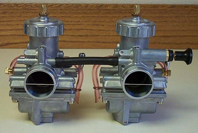

diesel60 Posted September 14, 2013 Report Share Posted September 14, 2013 (edited) Give everyone a little background Bike was running , would kick 1st or 2nd time but wouldn't idle. Did some investigation and realized my idle screws weren't working. Opened the TORs box and plastic was broke off inside (reason I couldn't set idle) I purchased a set of stock carbs on bhq that already had the idle screw drilled and tapped Unplugged TORs setup(main unit, each TORs box, and throttle switch), removed old carbs, installed TORs removal then new carbs Bike started but ran rich and then I realized i should check main jet (had 230, put back in 200) needle on 3rd click, a/s 2 turns out, Bike is completely stock. here are some pix of setup. Now I can't get it to fire at all.......hours later I am ready to Edited September 14, 2013 by diesel60 Quote Link to comment Share on other sites More sharing options...
serg88 Posted September 14, 2013 Report Share Posted September 14, 2013 Umm looks to me like ur missing ur main gas line on the t Quote Link to comment Share on other sites More sharing options...

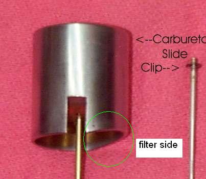

diesel60 Posted September 14, 2013 Author Report Share Posted September 14, 2013 I made sure the slots on the side of the slide lined up inside the carb- ..... Just so im not going crazy which slide is supposed to be on choke side? Any distinguishing factor? Thanks Sent from my iPhone using Tapatalk - now Free Quote Link to comment Share on other sites More sharing options...
hoppedupandcutdown Posted September 15, 2013 Report Share Posted September 15, 2013 Look in from the air box side for the cut away on the slide. Quote Link to comment Share on other sites More sharing options...
diesel60 Posted September 15, 2013 Author Report Share Posted September 15, 2013 (edited) Thanks hoppedupandcutdown - great post. Im going to add that image to my library so I don't forget....I did go back and verify and they are in correct. I did manage to get it started with WOT....wondering if I need the slides/throttle cable adjusted.....can't get this tuned in ... Edited September 15, 2013 by diesel60 Quote Link to comment Share on other sites More sharing options...
diesel60 Posted September 15, 2013 Author Report Share Posted September 15, 2013 BTW...isn't there a difference on the slides too though that one is on the choke side and one is on the right side? I confirmed the cutouts are facing filter side. Quote Link to comment Share on other sites More sharing options...
hoppedupandcutdown Posted September 15, 2013 Report Share Posted September 15, 2013 I'd bet that the pilot jets are clogged from sitting. Also make sure the "BB" is in the left carb bowl. Quote Link to comment Share on other sites More sharing options...
hoppedupandcutdown Posted September 15, 2013 Report Share Posted September 15, 2013 BTW...isn't there a difference on the slides too though that one is on the choke side and one is on the right side? I confirmed the cutouts are facing filter side. They will go in the opposite carbs backwards, so if the cut out is at the rear, they are in the correct carbs the correct way. Quote Link to comment Share on other sites More sharing options...
