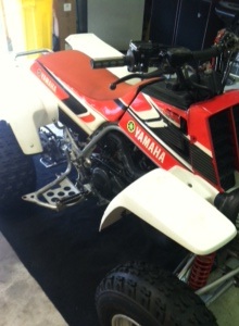

diesel60 Posted August 25, 2013 Report Share Posted August 25, 2013 Hi Bansheehq - been hooked on reading on this site for months. Ipad follows me every break I get, can't seem to stay off. So figured I would start posting. Here is the new banshee I just got. 2000 - all stock except tires, never been opened up! I knew it was going to be a little bit of a project but got it for what I thought was a good price. Here is a picture of it. I haven't quite figured how to post multiple pictures but I will learn. -Bike ran good - starts 1st or 2nd kick -Ran a compression test and around 70 lbs. of compression consistent on both sides - Ouch!! Quote Link to comment Share on other sites More sharing options...
