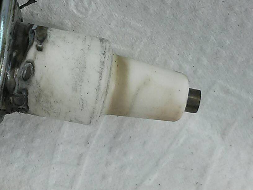

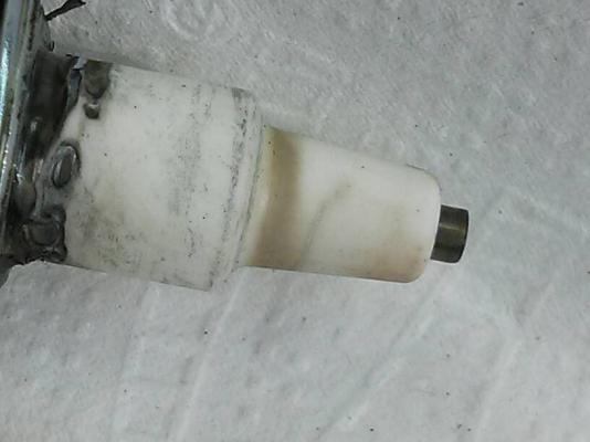

T_Shee Posted August 8, 2013 Report Share Posted August 8, 2013 Did a plug chop on my 250r. I thought it looks ok but you guys have always been really helpful. Thanks in advance sorry there arent 2 plugs lol Quote Link to comment Share on other sites More sharing options...
T_Shee Posted August 8, 2013 Author Report Share Posted August 8, 2013 Anyone Quote Link to comment Share on other sites More sharing options...
pickerg1 Posted August 8, 2013 Report Share Posted August 8, 2013 I'd ride it for a couple hours IMO. then have another look. Plug chops to me dont always tell the whole story. It doesn't look as though you are running real lean, so go beat her up for a bit and have another look. Quote Link to comment Share on other sites More sharing options...
T_Shee Posted August 8, 2013 Author Report Share Posted August 8, 2013 Ya the plug that i took out had been in there for a while and it looked real nice and tanish brown Quote Link to comment Share on other sites More sharing options...
Sandking Posted August 8, 2013 Report Share Posted August 8, 2013 Are you running a new plug threw all gears wot + 5 or 6 seconds. You don't ride it for a couple hours. Quote Link to comment Share on other sites More sharing options...
joey83 Posted August 9, 2013 Report Share Posted August 9, 2013 Do a quick wide open pull and keep it up in the main jet. Then pull that plug. Then you can do a low rpm run after main jet is dialed in. Quote Link to comment Share on other sites More sharing options...
T_Shee Posted August 9, 2013 Author Report Share Posted August 9, 2013 Sorry i meant the plug i took out before putting this one in had been in there for a while. This plug was put in with engine warmed up then i ran thru all the gears at wot for bout 1/8 mile then pulled the clutch and killed the engine Quote Link to comment Share on other sites More sharing options...
