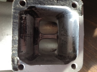

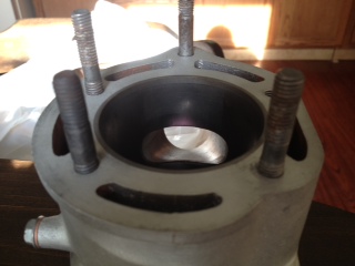

noonansar Posted July 18, 2013 Author Report Share Posted July 18, 2013 here are a couple of pics of the intake and exhaust ports Quote Link to comment Share on other sites More sharing options...

lms1977 Posted July 18, 2013 Report Share Posted July 18, 2013 If you can get a good measurement from the top of cyl to the top of exhaust port. As a reference as to how high the port was raised as long as they did not go to high which does not look like they went hog wild they might give ya a nice little bit extra. All depends what ya really want out of it. Quote Link to comment Share on other sites More sharing options...
noonansar Posted July 19, 2013 Author Report Share Posted July 19, 2013 I am hoping for some better mid range and top end. I paid 50 bucks for a complete 87 banshee not running and these were on it, so if these cylinders will run good without any transfer porting it is a bonus. Just trying to decide if it is worth the effort to swap these out and re-jet. My digital caliper wont fit inside my cylinder to get an accurate reading. I will try to measure it tonight and post the results. Quote Link to comment Share on other sites More sharing options...
noonansar Posted July 19, 2013 Author Report Share Posted July 19, 2013 The top of the cylinder to the top of the exhaust port is 28.5mm and 45mm wide measured straight across on a 65mm bore. Quote Link to comment Share on other sites More sharing options...
noonansar Posted July 19, 2013 Author Report Share Posted July 19, 2013 Did some more measuring. Exhaust: 28.5mm from top of cylinder to top of port, 71mm from bottom of sleeve to bottom of port, 45mm wide measured straight across. Intake: 71mm from top of cylinder to top of ports, 25mm from bottom of sleeve to bottom of ports, 50.5 wide measured straight across. Where can I expect power with these and how much compared to my current stock port cylinders considering transfers have not been ported. I am currently running dmc 916s, vf3 reeds. +4 timing, milled .030 stock head, pwk28 with uni pods, at sea level on 93 octane pump gas. Quote Link to comment Share on other sites More sharing options...
