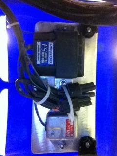

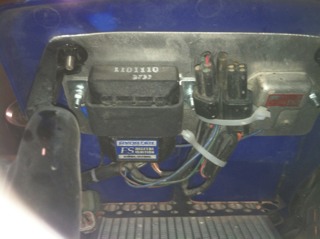

Finch Posted February 27, 2013 Report Share Posted February 27, 2013 Quote Link to comment Share on other sites More sharing options...
trickedcarbine Posted February 27, 2013 Report Share Posted February 27, 2013 I'm diggin finch's set up. Almost identical to what I wanted to do with mine but didn't have time this year. Quote Link to comment Share on other sites More sharing options...
WINDYCITYJOHN400 Posted February 27, 2013 Report Share Posted February 27, 2013 your CDI can mount with velcro right to the back of your tank. (between the seat and tank there is room.) Makes it easy to remove without tools and also a breeze for testing different CDI's if your having an issue. Quote Link to comment Share on other sites More sharing options...
spurdy Posted February 27, 2013 Report Share Posted February 27, 2013 I made an aluminum bracket and mounted it under the stock tank rear mount for the cdi (like Finch). Coil I left in the same place as it is practical. No regulator and no lights. That is a perfect place for the CDI because it attaches direct to the stator without the extension harness. Everything is right there close except the your run/stop circuit. SP Quote Link to comment Share on other sites More sharing options...
Finch Posted February 27, 2013 Report Share Posted February 27, 2013 ^yep Quote Link to comment Share on other sites More sharing options...
