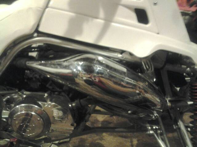

Do not ceramic coat the Shearers! I was about to nitro plate a set and called Mat about a raw set and had a short discussion about why I wanted them raw. He promptly explained that they should either be painted, chromed or raw. He mentioned a customer tried a set with jet hot coating and it was down 11 HP or so..... Some pipes it works, but Mat Shearer already has his pipe set up to move the heat the way it should. DO NOT CERAMIC COAT THEM.
Link to comment
Share on other sites
Those are raw? Lol wut
Raw! I polish with real compound a couple times a year. I learned how to take raw steel and make it look like chrome back in high school metals and jewelry classes.
Check out this shit, it's my finishing product I use periodically
