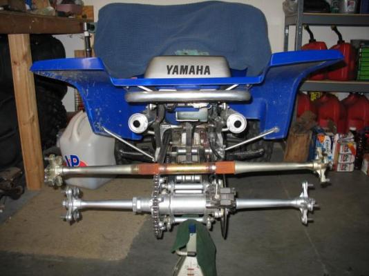

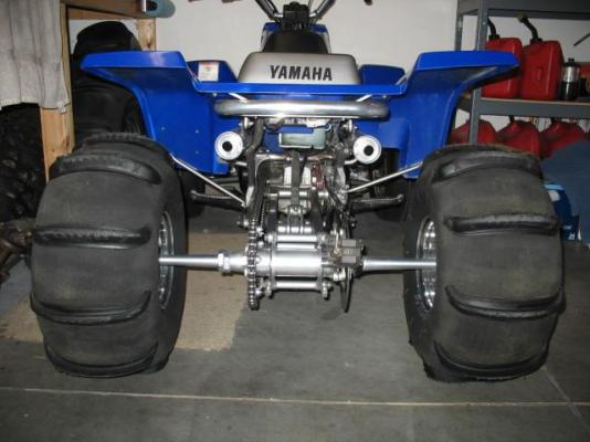

4strokekiller12 Posted January 18, 2013 Report Share Posted January 18, 2013 thinking about going this route is there any body that does the same thing If so input would be great Quote Link to comment Share on other sites More sharing options...
#1JUANstunna Posted January 18, 2013 Report Share Posted January 18, 2013 Yes it works. I think its 2 inches narrower than a banshee Quote Link to comment Share on other sites More sharing options...
special06shee Posted January 18, 2013 Report Share Posted January 18, 2013 Why? Cheaper version of a narrowed rear? A buddy of mine ran a blaster axle for a weekend just cause he bent his stock axle and was in a pinch. Quote Link to comment Share on other sites More sharing options...
Surfrjag Posted January 18, 2013 Report Share Posted January 18, 2013 Its 3.5 inches shorter and i have a couple i would sell if someone is interested. Quote Link to comment Share on other sites More sharing options...
BB3 Posted January 18, 2013 Report Share Posted January 18, 2013 I have run alot of blaster axles when i dont have the coin for a drag axle, they work pretty good on trail bikes too. Quote Link to comment Share on other sites More sharing options...
4strokekiller12 Posted January 18, 2013 Author Report Share Posted January 18, 2013 is there a certain year too do it and how much lighter are they Quote Link to comment Share on other sites More sharing options...
Surfrjag Posted January 18, 2013 Report Share Posted January 18, 2013 03+ Quote Link to comment Share on other sites More sharing options...
part-time Posted January 18, 2013 Report Share Posted January 18, 2013 I run one with a Honda style sprocket hub and wheel hubs turned in the opposite way!!! cheap drag axle.. Quote Link to comment Share on other sites More sharing options...
trickedcarbine Posted January 18, 2013 Report Share Posted January 18, 2013 Yep, blaster axle and flip the wheels offset and your hubs. Just use the big hub but to change the tires. Seen a few budget drag bikes like that Quote Link to comment Share on other sites More sharing options...
badbanshee509 Posted January 18, 2013 Report Share Posted January 18, 2013 im astually thinking of putting one on my bike also. I have a guy selling me one with everything to do the conversion for $40. im thinking hard on getting it Quote Link to comment Share on other sites More sharing options...
04_blu_shee Posted January 19, 2013 Report Share Posted January 19, 2013 I done it on my bike works great...makes for a narrower tire spacing when useing 5-3 Douglas wheels Quote Link to comment Share on other sites More sharing options...
werner Posted January 19, 2013 Report Share Posted January 19, 2013 Yep, blaster axle and flip the wheels offset and your hubs. Just use the big hub but to change the tires. Seen a few budget drag bikes like that Can you elaborate or have pics? Having a hard time visualizing this. Can't just swap blaster axle for banshee? Quote Link to comment Share on other sites More sharing options...
4strokekiller12 Posted January 19, 2013 Author Report Share Posted January 19, 2013 someone have a o3 blaster axle Quote Link to comment Share on other sites More sharing options...
special06shee Posted January 19, 2013 Report Share Posted January 19, 2013 someone have a o3 blaster axle Hit up pickelz or east coast atv! They have a HUGE selection of used parts Quote Link to comment Share on other sites More sharing options...
Surfrjag Posted January 19, 2013 Report Share Posted January 19, 2013 I posted above i have a couple of them. Pm me 45 shipped Quote Link to comment Share on other sites More sharing options...
