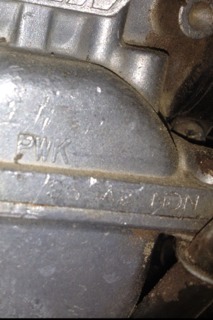

bansheefromhell Posted November 14, 2012 Author Report Share Posted November 14, 2012 Quote Link to comment Share on other sites More sharing options...
bansheefromhell Posted November 14, 2012 Author Report Share Posted November 14, 2012 Never seen that marking. I see S66, S63, S65, S46...but no S55. it might be 65, it's hard to tell Quote Link to comment Share on other sites More sharing options...
sprinklerman Posted November 14, 2012 Report Share Posted November 14, 2012 if it says S65, its a 35 A/Stryker. Does it have "fins" on the intake side of the carb? Quote Link to comment Share on other sites More sharing options...
bansheefromhell Posted November 14, 2012 Author Report Share Posted November 14, 2012 so you still haven't measured it? it kind of hard when you work 7-7 Quote Link to comment Share on other sites More sharing options...

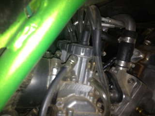

bansheefromhell Posted November 14, 2012 Author Report Share Posted November 14, 2012 it kind of hard when you work 7-7 this is the best photo I have right now Quote Link to comment Share on other sites More sharing options...
lms1977 Posted November 14, 2012 Report Share Posted November 14, 2012 thats a air stryker Quote Link to comment Share on other sites More sharing options...
bansheefromhell Posted November 14, 2012 Author Report Share Posted November 14, 2012 Says PWK on the side. I also see power jets it looks like. You running methanol? Sorry I can't help you out on the size, easiest way might be to get a digital (or non) ID measure tool. no but it is set up to run it Quote Link to comment Share on other sites More sharing options...
sprinklerman Posted November 15, 2012 Report Share Posted November 15, 2012 if its truly "setup" for alky,then they wont work on gas. The dump tube will be drilled out too big for gas. Quote Link to comment Share on other sites More sharing options...
