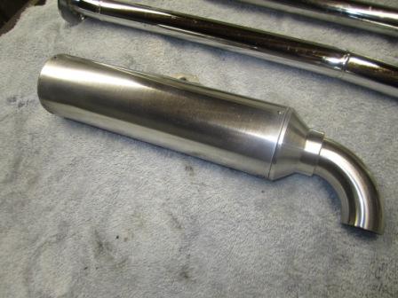

RaptorDuner Posted June 7, 2012 Author Report Share Posted June 7, 2012 Here is the silencer with the stainless tip that I made. I had to machine the end cap out to 1.25" to receive it and I think I will use JB Weld and a set screw from the bottom to retain it. Now all I need to do is pickup some polish & orings and then I can get them on. I'll get a db reading with fresh packing before & after the tips to see if they are a waste of time. Quote Link to comment Share on other sites More sharing options...
Banshee Chad Posted June 7, 2012 Report Share Posted June 7, 2012 Don't see how that'll make it quieter.. but I sure hope it works for you! Quote Link to comment Share on other sites More sharing options...
RaptorDuner Posted June 7, 2012 Author Report Share Posted June 7, 2012 It points the noise towards the sand which does a decent job of absorbing the sound and the db meter "hears" it as being quieter. Cascade Innovations has been using this trick for years on their silencers. Quote Link to comment Share on other sites More sharing options...

RaptorDuner Posted June 17, 2012 Author Report Share Posted June 17, 2012 Didn't turn out too bad and the freshly packed silencers measured out at 101db. I need to get it out in the grass to to see if the tips help cause I don't think that a cement floor and a steel table will show if it helps. I'm hoping for around 96db but I think that is optimistic Quote Link to comment Share on other sites More sharing options...

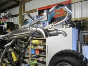

RaptorDuner Posted July 30, 2012 Author Report Share Posted July 30, 2012 This is kinda old by did ya ever get a chance to test em out side ? And did ya have a staring db level at all before you repacked and did the turn down ? I didn't have a baseline but in the grass they were 98-98.5 db. Law Enforcement was almost nonexistent at Florence Oregon over the July 4th Week so I never got hassled or a courtesy check. Here's a picture of them on the Banshee all put together. Quote Link to comment Share on other sites More sharing options...
