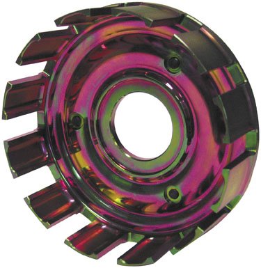

I'll call them and let you guys know what ends up happening. Do you guys know if Hinson makes this Hard Anodized Steel Basket for the Banshee:
This Basket looks indestructible.

Hinson does not make a steel basket for the banshee that i'm aware of.. I have been using a hinson for 10yrs now and still looks new.

Damn, I was hoping Hinson made a Hard Anodized Steel Basket, if they did and I couldn't get this issue resolved with Mattoon I was going to give the Steel Basket a shot. They are proud of them, most of them I've seen were in the $299 range.
