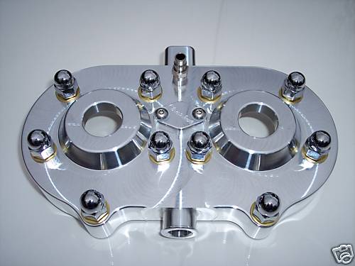

chayote86 Posted April 13, 2012 Author Report Posted April 13, 2012 Whats the difference between that one ^^ and the super duty chariot head? Quote

BelleauCarl Posted April 13, 2012 Report Posted April 13, 2012 Super duty head are one block head that have no combustion chamber, you need to get machined to your spec by a builder Quote

chayote86 Posted April 13, 2012 Author Report Posted April 13, 2012 So whats up with the different dome sizes? Quote
FASTOYS Posted April 13, 2012 Report Posted April 13, 2012 So whats up with the different dome sizes? Can run different domes for different alttitudes, compression ratios, porting , fuel reqirements, etc.... example 18cc for high altitude or race gas versus 21cc possible pump gas or sea level etc.. Quote
