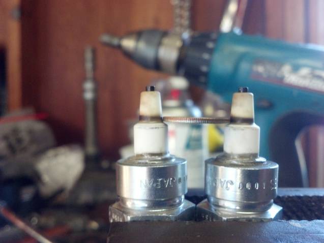

moledigger Posted March 5, 2012 Report Share Posted March 5, 2012 Did my first plug chop today on the new Dune/Play port from FAST. DMC 916 pipes, proflow with k&n no lid, 20cc domes 330 main, 27.5 pilot, Dynojet Needles 3rd from top out of 6 positions. Think I need to go up 1 on the pilot, have a bog off idle. The air screws don't have any effect until i go less then 1 turn in. At 1.5 the idle picks up slightly and doesn't get any higher the further you go out. The jet spec's that DMC calls out is a 30 pilot on a bone stock bike I assume, now I'm ported. What does every one think. Any pointers here are appreciated. Thanks BHQ Quote Link to comment Share on other sites More sharing options...

EvilBanshee Posted March 5, 2012 Report Share Posted March 5, 2012 Those plugs are FAT.( RICH) YOu want a light light tan color. NOw when tuning your main jets, put in a new set up plugs (GAPPED at .025-.030 on a semi stock engine). DO 4 or 5 WOT sessions. Run through the gears, hold it pinned the entire time, Once your topped out. Pull the clutch in and shut it down. THen check your plugs. IF i were you id drop your mains 2 sizes. See how it looks. When playing with your needles and pilots. GO fairly big swings. and see if it gets better. If you think u need a bigger pilot, go 5 sizes bigger. Same with the needles, go accouple clip's bigger or smaller. See if it clears up. or gets worse. Its hard to tell if u go 1 setting at a time. Quote Link to comment Share on other sites More sharing options...

RadarRacing Posted March 6, 2012 Report Share Posted March 6, 2012 I agree almost 100% with Evil. Main is rich by 2 sizes or better, pilot could probably go 2 or 3 larger. Dont forget to do a 1/2 throttle chop too to check your needle setting. I like to make the needle look just a little richer than the main chop. I hate riding bikes that are way fat on the needle. Very good job on not being lazy and actually tuning your bike correctly. Quote Link to comment Share on other sites More sharing options...

beebs Posted March 12, 2012 Report Share Posted March 12, 2012 How thick does the smoke band need to be, 2mm? It looks close to that maybe a little thicker. Quote Link to comment Share on other sites More sharing options...
cline Posted March 13, 2012 Report Share Posted March 13, 2012 How thick does the smoke band need to be, 2mm? It looks close to that maybe a little thicker. I read on another discussion that the band should be about the thickness of a dime. Quote Link to comment Share on other sites More sharing options...
EvilBanshee Posted March 13, 2012 Report Share Posted March 13, 2012 Id say the thickness on that plug band is bang on. BUt it looks like your running diesel in that engine. DRop 2 main sizes. YOU want a lighter color ring then that. More of a tan. Quote Link to comment Share on other sites More sharing options...
