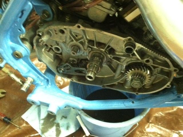

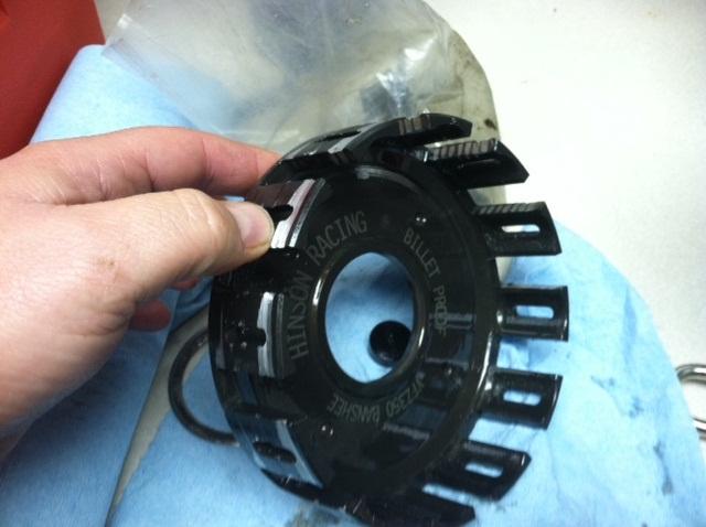

Blooddain Posted February 9, 2012 Report Share Posted February 9, 2012 I pulled my clutch cover last night just to find out my clutch pretty much blew apart. Ruined my Hinson basket and blew my gears all over the place inside that cover. Looks like i will be replacing the basket and the main gear and the smaller gear that slides inside the bigger main gear. What is that gear called? I can replace the basket easy enough (although i think i may go with a different brand basket this time) but i am having a problem finding the gears i need to replace. There are numerous sites that sell gears, but it seems like they are all "straight cut gears" instead of the regular gears. I also noticed that the case has been damaged by parts flying around in there near the crank seal. Im hoping i can fix this without replacing the case. Any help on where i can get these gears would be greatly appriciated! Quote Link to comment Share on other sites More sharing options...

Larry's Shee Posted February 9, 2012 Report Share Posted February 9, 2012 Pics or it didn't happen On another note what do you think really happened? Is the clip still holding the kick start idle gear? Quote Link to comment Share on other sites More sharing options...
Blooddain Posted February 9, 2012 Author Report Share Posted February 9, 2012 No, it was all apart, even the kick. I do have pics, however i do not know how to upload them. Quote Link to comment Share on other sites More sharing options...

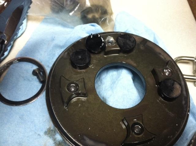

Broke_Banshee Posted February 9, 2012 Report Share Posted February 9, 2012 (edited) looks like the oil catcher for the clutch screws came loose starting the issue,or one of the basket screws backed up,did u use loctite? Edited February 9, 2012 by Broke_Banshee Quote Link to comment Share on other sites More sharing options...
Blooddain Posted February 10, 2012 Author Report Share Posted February 10, 2012 I didn't build it. Bought the bike, took it out for a ride, 3 hours into the ride, this happened. Called the guy i bought it from but he wont return my calls. Quote Link to comment Share on other sites More sharing options...
Broke_Banshee Posted February 10, 2012 Report Share Posted February 10, 2012 I didn't build it. Bought the bike, took it out for a ride, 3 hours into the ride, this happened. Called the guy i bought it from but he wont return my calls. i see it alot actually,alot of people dont believe in loctite but i use it like nothing,im betting thats what happened,easy enough to fix,of course i have hoarded parts for years and i just grab it off the shelf. Quote Link to comment Share on other sites More sharing options...

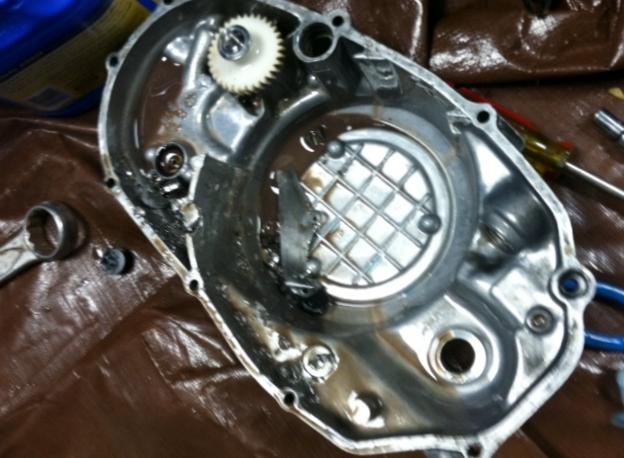

Blooddain Posted February 10, 2012 Author Report Share Posted February 10, 2012 see that big chunk out of the metal on the inside of that clutch cover? Think i need to replace the clutch cover also? Getting fuckin expensive lol Quote Link to comment Share on other sites More sharing options...
bansheesandrider Posted February 10, 2012 Report Share Posted February 10, 2012 Make sure you replace the gears on the crank- it looks like shrapnel ran through there and if it did, it is going to knock when you get it running. Quote Link to comment Share on other sites More sharing options...
