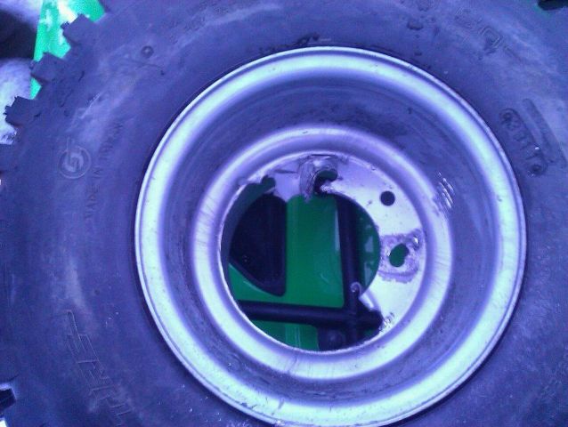

cable Posted December 29, 2011 Report Share Posted December 29, 2011 i bought a set of cheap ims steelies to run for ice oval this winter.. made it a half a day on them and sheared the entire center out of the wheel and it went skootin bout a half mile acrossed the lake .. anyone else ever have a problem with ims stuff like that?? this was the first time i ever used these wheels.. Quote Link to comment Share on other sites More sharing options...
Nieskes Posted December 30, 2011 Report Share Posted December 30, 2011 Hmm post up a pic, sounds interesting. Quote Link to comment Share on other sites More sharing options...

J.J. Posted December 30, 2011 Report Share Posted December 30, 2011 Looks like you might have egged out the bolt holes. Happened to me in the early days when I had nylon spacers at the rear. The bolt holes egged out badly, no matter how much I tightened the nuts. Still looks like a quality problem, regardless. Quote Link to comment Share on other sites More sharing options...
BigRed350x Posted December 30, 2011 Report Share Posted December 30, 2011 I would contact the wheel manufacturer and show them the pics and see if they can do anything to help you. Maybe get a set of wheels out of the deal... - Jared Quote Link to comment Share on other sites More sharing options...

cable Posted December 30, 2011 Author Report Share Posted December 30, 2011 Thanks. Ya I'm calling them tomorrow. This is the first and last time I buy wheels from them. It was definatly a puckered moment when I slammed the corner at 50+ mph on the ice and I saw my tire pass me up lol Quote Link to comment Share on other sites More sharing options...
Weltall Posted December 30, 2011 Report Share Posted December 30, 2011 What's the word from the manufacturer? Quote Link to comment Share on other sites More sharing options...
cable Posted December 30, 2011 Author Report Share Posted December 30, 2011 idk yet. i cant seem to find any info on contacting ims on there website. im going to call parts unlmtd. tuesday to see if they can help me out.. Quote Link to comment Share on other sites More sharing options...
