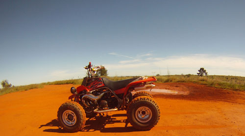

I bought a 06 banshee recently and been reading and searching on the net trying to find/learn as much as I could. But the jetting/carbs and pipes are like a black art to me. From what I can tell the bike has FMF powercore2 silencers with phatty2 headers. Stock air filter, with holes cut into the lid. The bike does tend to hesitate under wot. And the longer I ride it the worse it gets.

Snap some pics of the bike.. odds are some guys will be able to identify your parts easly.

I did strip the carbs and cleaned them, but once fitted them back I started the bike and heard a strage noise coming from the flywheel like something was lose behind the cover... I took everything apart and yep, turned out the pickup coil was just dangling next to the flywheel by the wires... the two mouting skrews were not only lose but broke off the moutings they skrew into the stator plate. (which means it leaned against the flywheel and got smashed) At this piont I felt like shit...
But this also means I can now invest in a adjustable plate and new stator with pickup coil from rickstator.
Other than that I bout a new kickstarter and replaced the clutchcable,plugs,trans oil and cleaned the filter.
