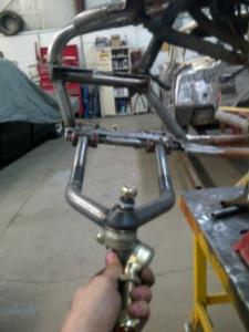

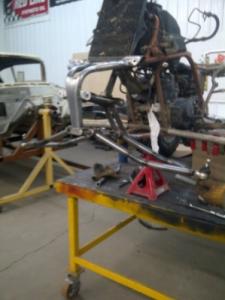

springer Posted September 27, 2011 Report Share Posted September 27, 2011 can't believe i havent seen this until now, but very nice. i like it. i have been wanting to do something very similar as soon as i get a duner to work on. maybe my wife's bike can be the tester. i must say though, very brave making the arms solid mount without any camber/cast adjustment options. obviously you can play with the ball joints, but not much. im guess you have done this before because for my first trial run, i will be putting hiems on everything so i can adjust it all til i know where everything should be. very nice!!!! Quote Link to comment Share on other sites More sharing options...

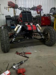

SNT Posted September 30, 2011 Author Report Share Posted September 30, 2011 well i finally got to drive it today front end lands nice ans smooth:) but i bent the axle and the axle bearings are fucked so where should i get a wider axle and bearing kit? best place? Quote Link to comment Share on other sites More sharing options...
camatv Posted September 30, 2011 Report Share Posted September 30, 2011 i would convert to a round carrier style and look at an lonestar or RPM axle if you want the best or a 200 bucko cheapo is your concernd on price. your fab skills are good enough i bet you could do a swingarm in a few days. Quote Link to comment Share on other sites More sharing options...
FireHead Posted September 30, 2011 Report Share Posted September 30, 2011 Did you doodle that up in CAD program or mock that up first? Quote Link to comment Share on other sites More sharing options...
Trick2stroke Posted September 30, 2011 Report Share Posted September 30, 2011 I have an LSR axle laying around I'd sell you for a little less than one of the cheapo aftermarket ones, at least you'd get out with a better axle. Shoot me a message if interested. I couldn't find the pics I thought I had of all the aftermarket geo frames, they're probably on my external hd somewhere. If I find them I'll shoot them your way. Definitely upgrade to the round style carrier, save yourself the headache of the god awful Yamaha chain adjustment. Quote Link to comment Share on other sites More sharing options...
