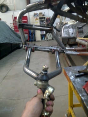

So Cal Suspension Posted September 20, 2011 Report Share Posted September 20, 2011 I'm going to pull my foot out of my mouth. Everything is coming together VERY well. Zilla is correct. You want your lower shock mount as close to the wheel as possible. I would set it in from the spindle about 4 inches, and optimum shock angle is roughly 35 degrees. Do us all a favor, though. Go start a photobucket account, and upload the original pictures. They will be big. I'm super interested in this project and I'll be watching closely for the finished product. Quote Link to comment Share on other sites More sharing options...

SNT Posted September 20, 2011 Author Report Share Posted September 20, 2011 I'm going to pull my foot out of my mouth. Everything is coming together VERY well. Zilla is correct. You want your lower shock mount as close to the wheel as possible. I would set it in from the spindle about 4 inches, and optimum shock angle is roughly 35 degrees. Do us all a favor, though. Go start a photobucket account, and upload the original pictures. They will be big. I'm super interested in this project and I'll be watching closely for the finished product. thanks MATTSCSS ok will do the shock mounting you guys suggested i tried to start a photo bucket but i got frustrated and mad.. im not a computer person in any way Quote Link to comment Share on other sites More sharing options...

SNT Posted September 21, 2011 Author Report Share Posted September 21, 2011 Quote Link to comment Share on other sites More sharing options...
So Cal Suspension Posted September 21, 2011 Report Share Posted September 21, 2011 Looks good man. Only suggestion I have is to move your lower shock mount in. It looks like in it's current position you're going to lose a little ride height, and drop-out. It's hard to tell without having the bike here to take measurements, but the shock angle looks about right. Ride height is the only issue I see as of now. Quote Link to comment Share on other sites More sharing options...
SNT Posted September 21, 2011 Author Report Share Posted September 21, 2011 thanks man:) yeah i wanna set it on the ground tomorrow and find out.. seee if i gotta move the mounts in im just using my buddys 450r shocks for mock untill i get the other ones i bought off decon.. Quote Link to comment Share on other sites More sharing options...

SNT Posted September 22, 2011 Author Report Share Posted September 22, 2011 well photobucket fucken pissed me off wont let me upload any pictures now.. so im just gunna add a before and finshed picture with my buddys 450r shocks on i still wanna raise the ride hight a bit i should get enough from the adjustment on the shocks but here it is Quote Link to comment Share on other sites More sharing options...
