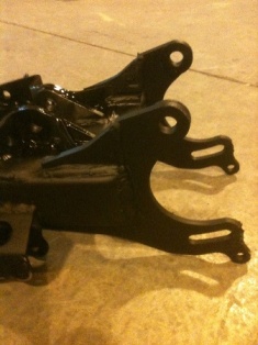

What is required for converting the stock swingarm to roundhouse? What has to be cut and what does the tube weld to?
Posted by Whitbread in another thread...
You can shorten it and add a roundhouse carrier easily at the same time. JJ&A racing has the tubes for cheap.
I shortened this one by about 3/4".

Not sure, maybe he meant that with the new modification the effective length of the swingarm with axle in place is 3/4 shorter than stock?
For sure a less expensive way to convert to a roundhouse carrier, I might try it when I have time...

Here are some pictures with the final result of the -2 swingarm
Wow looks great man that white powder coating really sets your bike off. Any pictures of the whole bike? And good job on the swing arm mod. I might have to try that one next.
