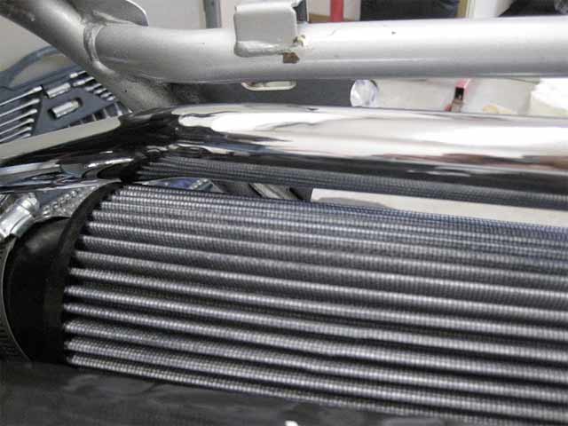

doug Posted July 16, 2011 Report Share Posted July 16, 2011 I'm having some trouble getting my sb inframe shearers to fit with my air filters. Anyone have any pics of their shearer setup they could share? Quote Link to comment Share on other sites More sharing options...
hp2000 Posted July 16, 2011 Report Share Posted July 16, 2011 Make sure you don't use hangers on the silencers (rear) mount them silencer to frame. Quote Link to comment Share on other sites More sharing options...

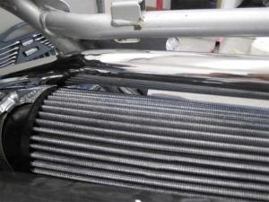

doug Posted July 16, 2011 Author Report Share Posted July 16, 2011 (edited) Are your Shearer's this tight to the air filter? (I'm connecting the stingers/silencers directly to the frame) Edited July 16, 2011 by doug Quote Link to comment Share on other sites More sharing options...

hp2000 Posted July 16, 2011 Report Share Posted July 16, 2011 Looks close to mine. Did you mount your head pipes on the outside of the pipe mount? Quote Link to comment Share on other sites More sharing options...
camatv Posted July 16, 2011 Report Share Posted July 16, 2011 welcome to shear's move the mounts all around and pull twist yank till they fit right. i have even put hose clamps at that spot in the pic where the filters rub to the frame and tightened them down till the pipes cleared. that actually worked really good.. the rear plasatic hides the clamp Quote Link to comment Share on other sites More sharing options...
crazycanuck Posted July 17, 2011 Report Share Posted July 17, 2011 I forgot to tell u earlier when you PM"d me, I had to use a bunch of washers to move them out from the head on the stator side. and a couple on the silencers too.. As Cam said welcome to shearers. That Cub will LOVE those pipes tho. nice choise Quote Link to comment Share on other sites More sharing options...
dirtydownunder Posted July 17, 2011 Report Share Posted July 17, 2011 white knuckle intake with 30degree uni pods, they have a good gap between them and the pipe, but with the 2nd stage filter they touch at the end. Quote Link to comment Share on other sites More sharing options...
camatv Posted July 18, 2011 Report Share Posted July 18, 2011 i have always felt the jig, bike or whatever shear made the pipes off of was tweaked or bent and they just didnt know it. they just dont fit all that great but with a lil rework would fit nerly perfect. and once you get them on and running you wont want to take them off.. hehe Quote Link to comment Share on other sites More sharing options...

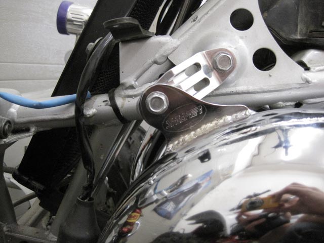

doug Posted July 21, 2011 Author Report Share Posted July 21, 2011 Looks close to mine. Did you mount your head pipes on the outside of the pipe mount? Hey There - it's on the outside, but I've heard that some people run the factory brackets. Do you think this would make any difference? I've attached a photo of the brackets that came on my bike when I bought it. I'm not sure what brand they are. Quote Link to comment Share on other sites More sharing options...
doug Posted July 21, 2011 Author Report Share Posted July 21, 2011 i have always felt the jig, bike or whatever shear made the pipes off of was tweaked or bent and they just didnt know it. they just dont fit all that great but with a lil rework would fit nerly perfect. and once you get them on and running you wont want to take them off.. hehe thanks for the input. I'd have to agree. Something isn't quite right here, but at least I know that other people have the same problems with these pipes. I can't wait to get it running. The build has been taken a while. I ordered up some of the heat sleeves from cascade and these filters, which will hopefully fit better. (I mention this for anyone else who may be going through the challenge of trying to get these pipes to fit.) http://67.199.65.66/cascade_innovations/newlook/store/single_Item_Display.cfm?STORE_item_ID=1689&department_id=103&area_id=13&search=k&n Quote Link to comment Share on other sites More sharing options...

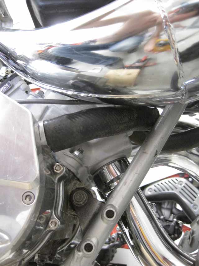

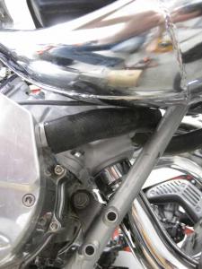

doug Posted July 22, 2011 Author Report Share Posted July 22, 2011 I'm also running damn tight to my rad hose...you guys must be experiencing the same thing? Quote Link to comment Share on other sites More sharing options...
dirtydownunder Posted July 22, 2011 Report Share Posted July 22, 2011 haha hey doug !! 421 cylinders also here, white knuckle intakes, vf3 reeds, tm34 carbs, 30 degree pods. with the bottom hose, i cant remember if i took it off and turned it around or what, but i have a good space between the pipe and hose. Quote Link to comment Share on other sites More sharing options...
