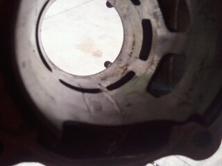

Irishchris Posted May 21, 2011 Report Share Posted May 21, 2011 Just pulled my engine apart and in the right cylinder the is 2 really deep groves in on the wall. I was wondering what could cause this and is it fixable. I posted the best pic i could get with my cell. Quote Link to comment Share on other sites More sharing options...
camatv Posted May 21, 2011 Report Share Posted May 21, 2011 did the wrist pin come out?? Quote Link to comment Share on other sites More sharing options...
Irishchris Posted May 21, 2011 Author Report Share Posted May 21, 2011 did the wrist pin come out?? No the piston looked like it was on there right, the engine was running fine I was tearing it down to get it ported and put a stroker kit in it. Quote Link to comment Share on other sites More sharing options...
Larry's Shee Posted May 21, 2011 Report Share Posted May 21, 2011 Have you ever had this engine apart before? What does the end of the pin look like on that side? was there a cir clip there? Quote Link to comment Share on other sites More sharing options...
malcman Posted May 21, 2011 Report Share Posted May 21, 2011 Wow, deja vu much. I pulled my motor apart last weekend and have the exact same marks on my cylinder. I was missing a wrist pin cir clip on that side though which would explain my marks. Quote Link to comment Share on other sites More sharing options...
Irishchris Posted May 21, 2011 Author Report Share Posted May 21, 2011 Wow, deja vu much. I pulled my motor apart last weekend and have the exact same marks on my cylinder. I was missing a wrist pin cir clip on that side though which would explain my marks. Yeah it sucks the motor was .20 over but I have only had it a few months, looks like time for some new cylinders. Quote Link to comment Share on other sites More sharing options...
ECshee Posted May 21, 2011 Report Share Posted May 21, 2011 the distance between the 2 marks is almost the same size as OD of the wrist pin.. it looks like? better hit the F/S section quick, theres a couple sets of cyls for sale! Quote Link to comment Share on other sites More sharing options...
malcman Posted May 22, 2011 Report Share Posted May 22, 2011 Yeah it sucks the motor was .20 over but I have only had it a few months, looks like time for some new cylinders. I hear ya, mine blew up the first time I had it out lol. Quote Link to comment Share on other sites More sharing options...
Jereme6655 Posted May 22, 2011 Report Share Posted May 22, 2011 that has to be what happened.....a cir clip popped out or was never reinstalled and the wrist-pin wiggled a little way out.....enough to cause its to dig in hard to the cylinder walls. Quote Link to comment Share on other sites More sharing options...
