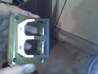

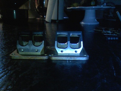

ok guys,i know how we like to look at home porting lol.what do u think??i didnt touch factory angles inside,i just opened her up a little and cut the center bridge to 4mm.im also close to 5mm from center of screw holes.i blocked down the face with 150 grit to flatten and smooth the swelled rubber for good reed seat.im using tdr epoxy resin carbon fiber single reeds with these.middle pic is what they both look like done,first is the difference from factory as well as the third,though the third wasnt smoothed out yet.be easy on me,i didnt do that much,im trying to stay safe but increased flow.i can get my thumbs in there as the factory i couldnt.think i did an okay job myself :dance: lol

lol,thanks fellas.i hope my ass dyno also gives me great results,tho i did have vf3's so i prob wont notice.ive done them before and didnt notice anything,power wise,but if i keep throttle response i will be happy.
