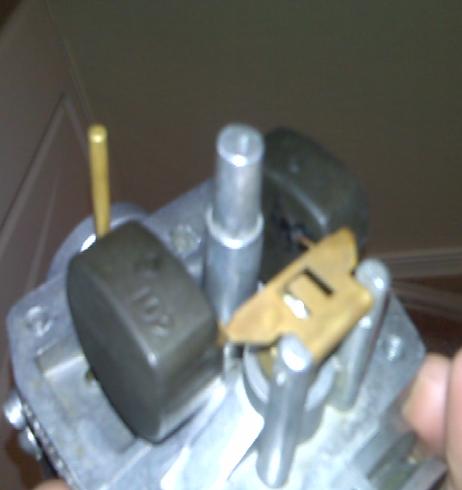

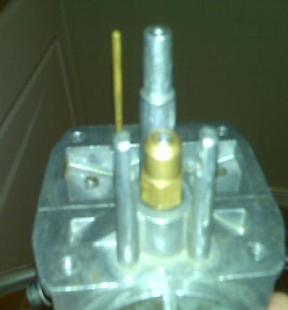

GrMeyer Posted July 14, 2010 Report Share Posted July 14, 2010 Ok so here is the deal. I need to make sure I have to right needle and starting point for my bike with these carbs on GAS for now and maybe later on this year for Alcohol. Bike Stock Stroke .50 over bore. Aggressive dune porting. CPI inframes Elevation 1117ft Temps - Umm F'n HOT 90-110 for right now. The needles in the carbs are LECTRON #16-4 Where can I get my Lectron needs? I know of Packard, Fast by Gast and Lectron Fuel Systems. I would rather have the guys on here help! Thanks Quote Link to comment Share on other sites More sharing options...

camatv Posted July 19, 2010 Report Share Posted July 19, 2010 ak's look like the ones that were set up for an RZ street bike. they have a single throttle cable on them and are connected at the top for the throttle set up. i think i know what you did you added a idle air mixture ( fuel added?) OR like injection you added a base idle air screw. ( air only) the slide stays put and the air is bypassed through your needle assembly with filter'd air, to the front of the carb its just kinda hard to see what you did with the picture and the description you have. am i right at all? interesting idear to fine tune the idle mixture you would have to change needle's and that is kinda sucky if the rest of the rpm range is right on. you could also change the cut out on the slide but that would be tricky also i would LOVE to see a set of slide released for these that are chrome or nickle plated. the oe's wear out way to fast. Quote Link to comment Share on other sites More sharing options...

No Limit Powersports Posted July 29, 2010 Report Share Posted July 29, 2010 The slide would def have to be machined different because of the thickness of the plating. Chrome would probably be .01-.02 thick i would imagine. Dennis told me not to long ago that lectrons were manufactured in Texas. As far as your setup take some pictures of your needle and seat/float setup those pictures are really tough to see anything. Quote Link to comment Share on other sites More sharing options...
