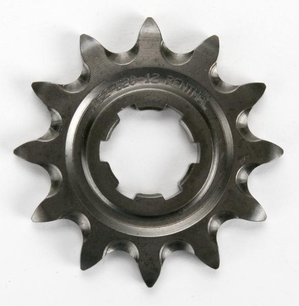

The Juris Doctor Posted May 31, 2010 Report Share Posted May 31, 2010 Yeah I hammered it down flat. Good idea though I will go get some from Yamaha. On the front sprocket, one side is smooth and the other side has a groove all the way around it. Which side should be pointint out toward my foot - the flat side or the grooved side?? Quote Link to comment Share on other sites More sharing options...
locogato11283 Posted May 31, 2010 Report Share Posted May 31, 2010 id put the flat side out. Quote Link to comment Share on other sites More sharing options...
