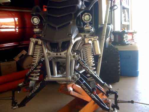

cangus Posted May 13, 2010 Report Share Posted May 13, 2010 Just put a Full Flight +2 kit on my shee and yfz450 shocks. I have yet to put the wheels on and do a hot lap with it yet though. Im a bit hesitant because its sitting pretty high and my joints are about maxed out. Anyone have a similar set-up here? Quote Link to comment Share on other sites More sharing options...
DiSkOe*1 Posted May 13, 2010 Report Share Posted May 13, 2010 Just put a Full Flight +2 kit on my shee and yfz450 shocks. I have yet to put the wheels on and do a hot lap with it yet though. Im a bit hesitant because its sitting pretty high and my joints are about maxed out. Anyone have a similar set-up here? the shocks have no load...lmao... reason ur so maxed out... mount it up and sit on it.... should be fine... and change them plastics...lmao... DiSkOe*1 Quote Link to comment Share on other sites More sharing options...
