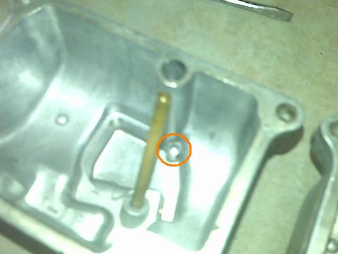

zr2highrider Posted February 18, 2010 Author Report Share Posted February 18, 2010 Ya i went through EXACTLY what your talking about! When i got this shee about 2 months ago, the guy threw in an extra set of stock carbs. The bowls were not the right ones on the bike so I swapped them out. During the swap I figured I would compare the bowls that were on it to the other bowl. They were ALL diffrent. The bowls that had the pickup for the choke (had 2 of them) were even diffrent. One just had a pickup but the other had a hole at the bottom of the pickup tube. This is litterally drivin me crazy!!! here is the one with the hole the one without the hole if anyone knows anything about this please chime in!! Quote Link to comment Share on other sites More sharing options...
skj283 Posted February 18, 2010 Report Share Posted February 18, 2010 (edited) the one with the hole in the bottom is the one with the jet in it for the choke. that hole is a pickup for the fuel to go into the well. so it needs to go on the carb with the actual choke knob. i just went out and checked mine and it started literally 1st kick after sitting all night. huge relief. look straight down in those deep holes and the bigger one will have that jet in the bottom. shoot some carb cleaner or air through it to make sure it isnt choked once you find what im talking about. if those are swapped it bascially makes ur choke have no fuel supply so when u open it it just adds a little air and no fuel. hope u get it. it fixed mine and im stoked cuz it was driving me nuts before. Edited February 18, 2010 by skj283 Quote Link to comment Share on other sites More sharing options...
