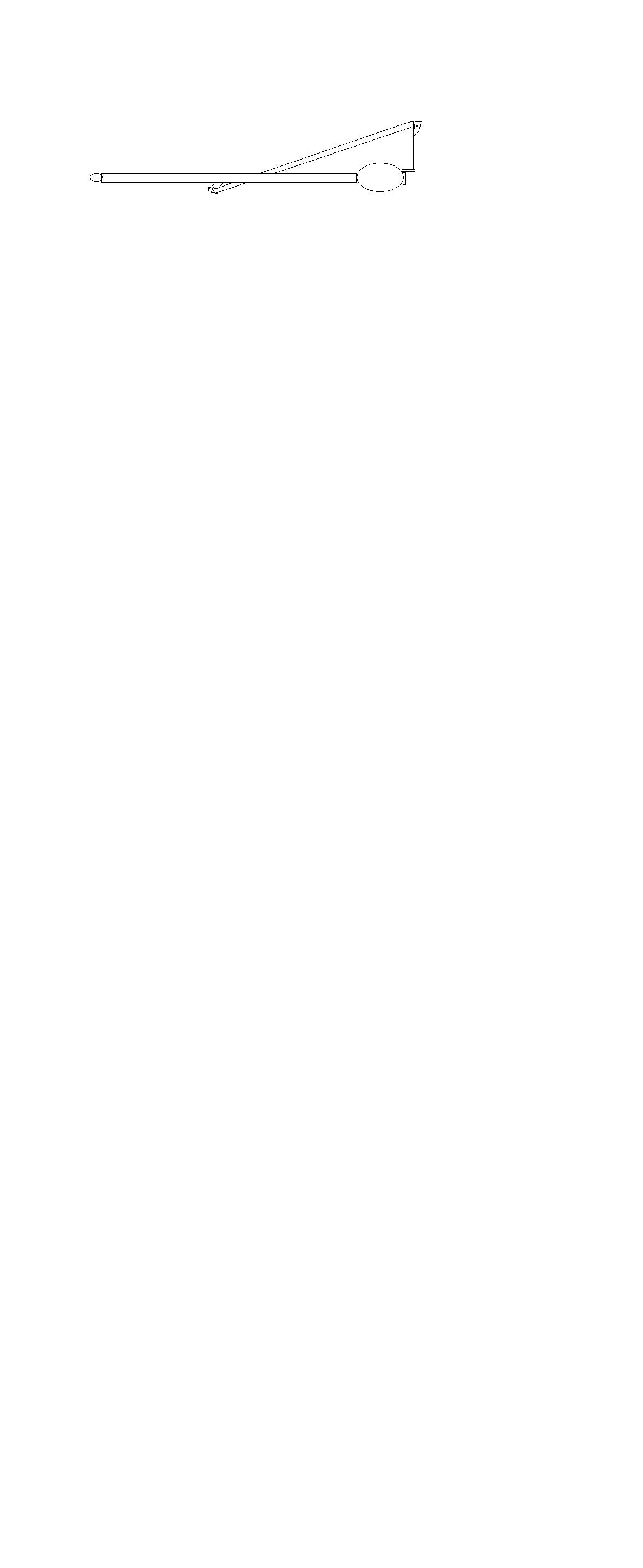

badassbanshee479 Posted October 14, 2009 Report Share Posted October 14, 2009 just build ya alittle mount like the pic I drew up for ya... the front of it mounts at the bolt for the shock strut etc... and the back mounts at the pinch bolts... just mount the lower wheelie bar heims on the pinch bolts and then mount he top bar to the tab of the mount I drew up for ya.... thi way here you can remove it all if you go to the dunes or something Quote Link to comment Share on other sites More sharing options...

joee20002 Posted October 14, 2009 Author Report Share Posted October 14, 2009 just build ya alittle mount like the pic I drew up for ya... the front of it mounts at the bolt for the shock strut etc... and the back mounts at the pinch bolts... just mount the lower wheelie bar heims on the pinch bolts and then mount he top bar to the tab of the mount I drew up for ya.... thi way here you can remove it all if you go to the dunes or something thanks for all the input guys... ya im thinking the sketch you have there is the way to go.... now hte wheely bar it self do i need to make all three mounting points adjustable? and how long? Quote Link to comment Share on other sites More sharing options...
badassbanshee479 Posted October 14, 2009 Report Share Posted October 14, 2009 thanks for all the input guys... ya im thinking the sketch you have there is the way to go.... now hte wheely bar it self do i need to make all three mounting points adjustable? and how long? mine is only adjustable on the top bar... and I believe you want it to be about 90% of your wheel base... so say around 6ft.... Quote Link to comment Share on other sites More sharing options...
dajogejr Posted October 22, 2009 Report Share Posted October 22, 2009 JOe, Go right back to Tyson and have him make you a wheelie bar mount for that arm. I run exactly what badass is talking about . front mounts to the lower shock mount, the back mounts above the pinch bolts on a plate. Quote Link to comment Share on other sites More sharing options...
