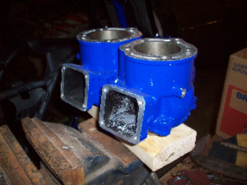

2strokesmoker Posted April 21, 2009 Author Report Share Posted April 21, 2009 my raptor 660 thats got 52 hp to the wheels vs my banshee was well even most of the time. My brothers got a 700r putting out 60hp to the wheels and it smoked my banshee. But all my banshee had was pods, fmf fattys and noss cool head 20cc domes. So all in all...Im going to say porting will be the biggest key in killing a moded raptor. So what kind of port should i get? Trail port? Just a smoothie? Dont really want to buy another set of jugs. I just had the ones I have powder coated and they are a fresh bore. I know if I have them ported and burn it down theres no sleeve to bore again. The wesico book my buddy has says you can bore .200 over yeat thats not twenty thou thats two hundred thou. My jugs are at .100 (100) over right now so dont i have a couple bores left? Here is a couple pics! Quote Link to comment Share on other sites More sharing options...
sheefreak Posted April 21, 2009 Report Share Posted April 21, 2009 You are on the last bore. .100 over is it. Quote Link to comment Share on other sites More sharing options...
2strokesmoker Posted April 21, 2009 Author Report Share Posted April 21, 2009 You are on the last bore. .100 over is it. so if i have them ported and burn it down i will have to have it ported again after new sleeves are installed correct? Quote Link to comment Share on other sites More sharing options...

Burt Reynolds Posted April 21, 2009 Report Share Posted April 21, 2009 Dont port .100 over cylinders. A lot of people wont even bore their bikes to .100 over.Things are just getting to thin at that point IMO. You can buy a set of low bore cylinders for under 200 bucks if you look around. If you want,i know a couple guys who do AWESOME port work for banshees in the 300-350 dollar price range wich is cheap. Quote Link to comment Share on other sites More sharing options...
