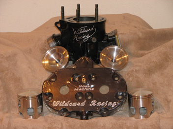

jbooker82 Posted March 31, 2009 Report Share Posted March 31, 2009 my elevation is 305 ft. and im running 93 octane synthetic mix . my compression 120 both cyl . and the pipes are made for mid range power i can find out the jets if need be. so whats a good coolhead? and timing plate ps this bike is all trail sometimes track A noss machine head is what I would go with. You dont have to change the cylinder head studs with his. You can get it in 3 anodized colors. Banshee HQ members get 10% off. Acording to noss's web page 21cc domes at sea level will put you at 156psi. It looks like his anodized heads are out of stock. You can get a Noss machine head from FAST that has the FAST logo engraved on it. Same with Herr Jugs, Wild Card Racing. www.farmandsandtoys.com http://www.herrjugsracing.com/ slobanshee06 is who you need to contact for a Wild Card Racing Head. Just PM him. Quote Link to comment Share on other sites More sharing options...
