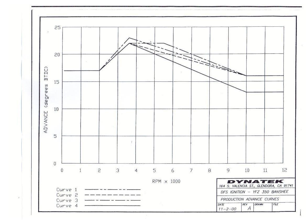

dajogejr Posted March 24, 2009 Report Posted March 24, 2009 Funny... On my 4 mil race gas with 4 on the plate, it liked the 3rd curve as well...lots of initial timing but retards faster then the rest as the R's go up, if I remember correctly.... Quote
Snopczynski Posted March 24, 2009 Report Posted March 24, 2009 Starts with the same advance, and then holds for a while and tapers off with the same slope as the rest, ends near the same amount of timing as the other 2 curves. All the curves are more advanced than the stock one in slot 4. Quote

Snopczynski Posted March 25, 2009 Report Posted March 25, 2009 Do these curves yall are talking about come on the dyna? it also says, it has automatic throttle cut off for clutchless shifting. is that good or bad on the tranny? Its good for the tranny, but you have to wire it up for it to work. The dyna comes with 4 curves. 3 is pretty popular. curve 4 is the stock curve. Quote
