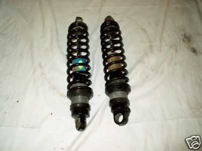

85yota Posted March 23, 2009 Report Share Posted March 23, 2009 anyone know anything bout these fox shocks off a banshee? they measure 14.25. i ride trails hit your average hills and jumps. i was looking to upgrade a little, i wanted to do the 450 shocks but told i was better off with soemthing made for the bike. waht do you guys think? any other suggestions Quote Link to comment Share on other sites More sharing options...

SandRageShee Posted March 27, 2009 Report Share Posted March 27, 2009 14.25 is shorter than stock i believe? i have some works on mine that are 15.25 and it sits nice and like stock..so i think those would lower the front a little.im not sure dont take my word.just my .02 Quote Link to comment Share on other sites More sharing options...
Corndiddly5885 Posted March 27, 2009 Report Share Posted March 27, 2009 14.25 is shorter than stock i believe? i have some works on mine that are 15.25 and it sits nice and like stock..so i think those would lower the front a little.im not sure dont take my word.just my .02 i am pretty sure too that stock shocks are 14.5 i am riding on 13.5 KYB's and i hate them its to low Quote Link to comment Share on other sites More sharing options...
85yota Posted March 27, 2009 Author Report Share Posted March 27, 2009 they are shorter i believe as well. im looking at a set of works now how do u like yours they are dual rates no rezzies Quote Link to comment Share on other sites More sharing options...
peterlocal22 Posted March 28, 2009 Report Share Posted March 28, 2009 they are shorter i believe as well. im looking at a set of works now how do u like yours they are dual rates no rezzies i would get the works over the fox shocks you posted a pic of Quote Link to comment Share on other sites More sharing options...
BansheeJohn Posted March 28, 2009 Report Share Posted March 28, 2009 Those are great shocks if you have them set up correct. You should be able to get those to 15" with a rebuild and new shaft ends. I'm sure they came off a mid to late 90's sled. Check you local dealer for a rebuild guy. Or you can call Steve at Deycore. http://deycore.com/index.htm Quote Link to comment Share on other sites More sharing options...
