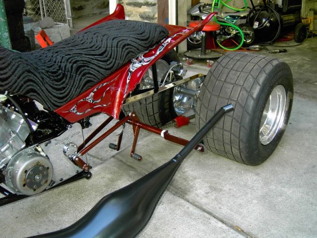

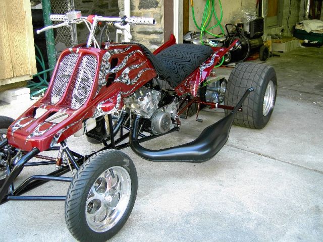

NYUK Posted March 18, 2009 Report Share Posted March 18, 2009 my old bike. Quote Link to comment Share on other sites More sharing options...
Wicked Motorsports Posted March 19, 2009 Report Share Posted March 19, 2009 my old bike. Very nice and clean! got anymore pics? Quote Link to comment Share on other sites More sharing options...
NYUK Posted March 19, 2009 Report Share Posted March 19, 2009 check my gallery. Quote Link to comment Share on other sites More sharing options...
bam_Banshee_02 Posted March 20, 2009 Report Share Posted March 20, 2009 Bolted to chain slider. Also to the frame. How much space is between your metal bracket and the top chain? How far did you go up to prevent you chain from slapping that guard? Quote Link to comment Share on other sites More sharing options...
rb0804 Posted March 20, 2009 Report Share Posted March 20, 2009 (edited) NYUK Is that an outboard bearing support? Where did you get it? The only one that I have seen was from packard. Are those grand river pipes? Edited March 20, 2009 by rb0804 Quote Link to comment Share on other sites More sharing options...
NYUK Posted March 20, 2009 Report Share Posted March 20, 2009 NYUK Is that an outboard bearing support? Where did you get it? The only one that I have seen was from packard. Are those grand river pipes? yes grr pipes. bearing support was from chuck wilburn. chariot makes them also. Quote Link to comment Share on other sites More sharing options...
NYUK Posted March 20, 2009 Report Share Posted March 20, 2009 Quote Link to comment Share on other sites More sharing options...
njbanshee Posted March 20, 2009 Report Share Posted March 20, 2009 NYUK that bike is sick. I never seen that done before. Some day i'll get there. Quote Link to comment Share on other sites More sharing options...
