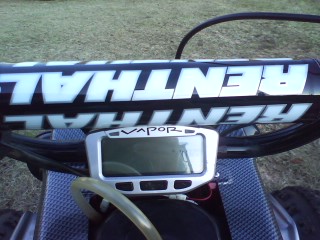

sandman81 Posted March 20, 2009 Report Share Posted March 20, 2009 i like mine. no complaints. the mounting bracket that comes with it kinda sucks tho. i made a home made one. nice banshee, like your bracket set up. :thumbsup: hey do you think you could post a picture of your setup from the riders perspective? Quote Link to comment Share on other sites More sharing options...
vulvafan537240 Posted March 20, 2009 Report Share Posted March 20, 2009 nice banshee, like your bracket set up. :thumbsup: hey do you think you could post a picture of your setup from the riders perspective? Quote Link to comment Share on other sites More sharing options...
sandman81 Posted March 21, 2009 Report Share Posted March 21, 2009 SWEET! that's in the perfect spot. guess i'm gonna have to steal your idea. Quote Link to comment Share on other sites More sharing options...
vulvafan537240 Posted March 21, 2009 Report Share Posted March 21, 2009 SWEET! that's in the perfect spot. guess i'm gonna have to steal your idea. cool. i just got a piece of aluminum, cut it down, drilled the holes, and bent it in a break ( i have access to a machine shop). i bent it by hand to get it at the perfect angle while it was mounted. best of all it was free! Quote Link to comment Share on other sites More sharing options...
