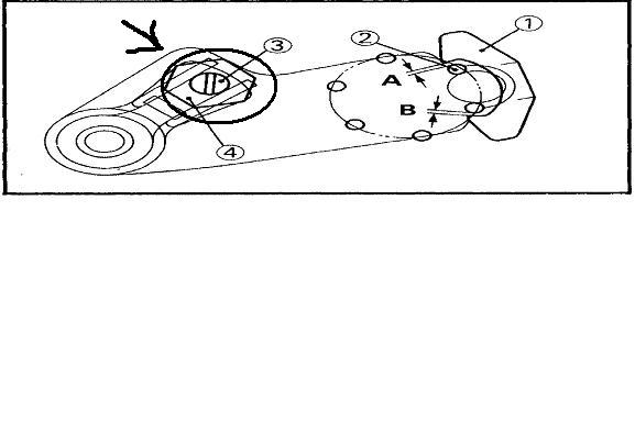

Make sure it is pressed in all the way. this thread should help with the adjustment. http://www.bansheehq.com/forums/index.php?...haft+adjustment
Top photo shows how it is out of adjustment. Last photo show the lock washer and adjustment slot needed tp adjust it. The hooks should be evenly spaced to the pins on the star when in neutral.

Here is what the shift shaft adjustment should like. Gap a and b have to be the same
