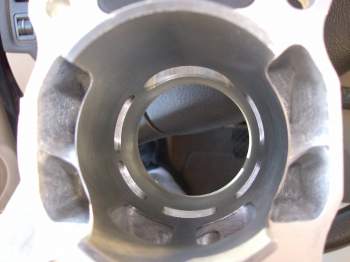

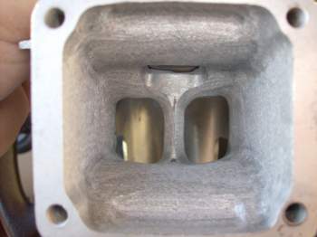

2slow350 Posted February 19, 2009 Report Share Posted February 19, 2009 What exactly are you guys looking for, and what is the author of this post looking for everyone to say? Portwork cannot be determined by just looking at the cylinders. There are port heights and widths that need to be measured to tell what someone did. All that looks like right now is that someone went in and ground on the intakes and the transfers, then knifed the intake bridge. I agree.. Who said you had to have boost ports?? Had many stockers ported by some well known builders and didn't have boost ports.. Matter of fact I have some from Jeff/FAST And the boost ports have been filled in.. Jmo Quote Link to comment Share on other sites More sharing options...
lambchop Posted February 19, 2009 Author Report Share Posted February 19, 2009 What exactly are you guys looking for, and what is the author of this post looking for everyone to say? Portwork cannot be determined by just looking at the cylinders. There are port heights and widths that need to be measured to tell what someone did. All that looks like right now is that someone went in and ground on the intakes and the transfers, then knifed the intake bridge. I guess what i was looking for was someone to say that they look GOOD! Cause lord knows I didn't want to get screwed, but I guess everyone needs a good screwing now and again Quote Link to comment Share on other sites More sharing options...
RUDEDAWG Posted February 19, 2009 Report Share Posted February 19, 2009 Hey bro! they look very good, now slap them bitches on and see how good they run! Only then you'll see how good they (look)! Quote Link to comment Share on other sites More sharing options...

deckheight Posted February 22, 2009 Report Share Posted February 22, 2009 After re-reading my previous post this morning... That wasn't a very nice reply. Sorry! Nobody can tell from a picture what is really going on with a port job... They can however get a sence of wether or not that person knows what they are doing. And your new porting looks to me like whoever did it has done it before and is familiar with porting tools. I would think you should be happy with it. I would also think that whoever did the work could tell you what you want to know. However, if for whatever reason, they cannot... And you can provide accurate port mapping data, I would be more than happy to tell you exactly what you have and what it is supposed to do. Again, I apolagize. Good luck Quote Link to comment Share on other sites More sharing options...
Leadfoot350 Posted February 22, 2009 Report Share Posted February 22, 2009 if you measure the top of the cylinder to the exhaust port and to the transfer ports then guys on here will be able to tell you about the port job. By looking at it I like the flow a lot. He did not go too big on the intake and went for flow and on the transfer tunnels he made them huge which is great. Measure the distance for us and we can tell you what pipes and what rpms the power will come on. Quote Link to comment Share on other sites More sharing options...
