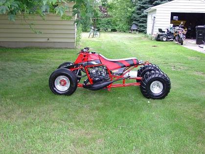

330 R killer Posted February 8, 2009 Report Share Posted February 8, 2009 I FUCKED UP I JUST POSTED UNDER IMAGES...Ok here is my Question. I hooked up my old Nos kit from my street bike to my shee, The shot is going to be a 20 shot, What should my timing be at? -5?? or is that to much? Has anyone on here ever run nos a shee? i have run nos on my srteet bikes for years with no problem at all, can somone help me with the timing.. Thanks Quote Link to comment Share on other sites More sharing options...

330 R killer Posted February 8, 2009 Author Report Share Posted February 8, 2009 (edited) Ya, I have seen people grenade their entire engine following that kind of advise.......... Rods going thru cases...........Nothing left of the piston but a molten blob in the pipe.......ya know bad stuff.......... Definetly more than just a rebuild.....LOL...... Ok here are my mods....Bored to 66 mm full race port,timing plate + 4 36 mm carbs, alba carb spacers, V Force 3 reeds, Ture and welded crank, Chariont head with 19 cc domes. and T5's I have been running and turning street bikes with nos for years Easy, just was not sure about 2 strokes..the kit is a dry system i drilled it into my carbs to put the nozele upped the jets from 310 to 340 going to go for a ride right now down the street and spray it let you know what happens in about 10 min..hope i am not pusheing it back lol wish me luck and my timing is set at -3 right now Edited February 8, 2009 by 330 R killer Quote Link to comment Share on other sites More sharing options...
330 R killer Posted February 8, 2009 Author Report Share Posted February 8, 2009 Ok here are my mods....Bored to 66 mm full race port,timing plate + 4 36 mm carbs, alba carb spacers, V Force 3 reeds, Ture and welded crank, Chariont head with 19 cc domes. and T5's I have been running and turning street bikes with nos for years Easy, just was not sure about 2 strokes..the kit is a dry system i drilled it into my carbs to put the nozele upped the jets from 310 to 340 going to go for a ride right now down the street and spray it let you know what happens in about 10 min..hope i am not pusheing it back lol wish me luck and my timing is set at -3 right now :biggrin: :biggrin: :biggrin: That shit was fun 20hp is alot, Fu*k that pulled hard in 3 and 4th..just a little me tuning and i think i got it..thanks guys for all your help. Quote Link to comment Share on other sites More sharing options...
