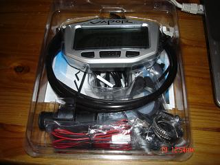

Just bought.. any tips for install?
hollisatp
i powered mine from the hot wire going to the headlight switch. the temp sensor splices into the radiator hose, tach wire needs to be taped onto the plug wire (thats right, just tape about 1" of the wire onto it and use electrical tape), use the supplied bracket to mount speedo cable, and use any screw that mounts to the frame for a ground.

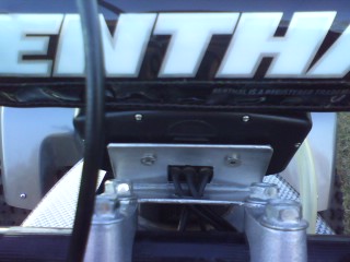

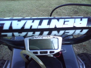

did you buy the billet mount also? the plastic bracket that comes in the kit sucks. i made my own mount. ill post pics of it later on today. and i believe you splice the radiator hose between the head and radiator.
