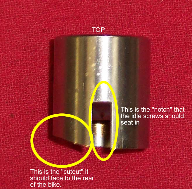

Tim Potteiger Posted October 1, 2008 Report Share Posted October 1, 2008 This is a real obvious one, but if they are stock carbs, when re-installing the slides, did you put the slide cut-aways to the rear? Quote Link to comment Share on other sites More sharing options...
