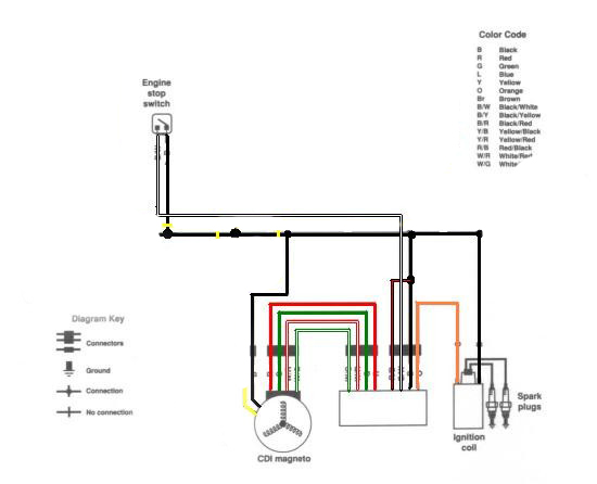

XxMeltIcexX Posted September 26, 2008 Report Share Posted September 26, 2008 Word Tyler. Heres my wiring harness, only CDI, coil, and killswitch. Quote Link to comment Share on other sites More sharing options...
