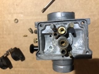

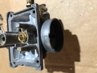

  3. So I pulled the carbs and began deconstruction. They are in rough shape . Filthy, rusty , White deposits . Hope I can save them . One is chipped on intake I believe. As far as the jetting is concerned .. both mains look like 370. One pilot reads 25 . Other is newer but I can’t read it . Hole does look smaller on it maybe. I need to soak these carbs for a day or two .. any ideas in what to soak them in?
