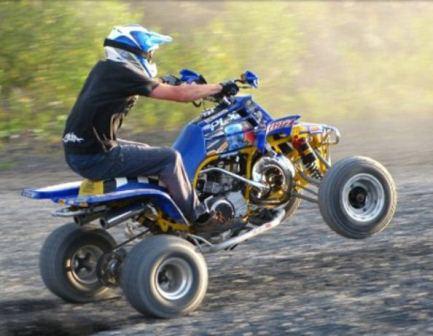

  14. I see this pic every time I log in. Just never seen pipes like these. What brand are they and what are they designed for, low end, mid-range, top end etc? I'm sure it's a member's ride so I'd like to say it is a sweet looking machine and, by the way, I hope you don't mind me posting the pic

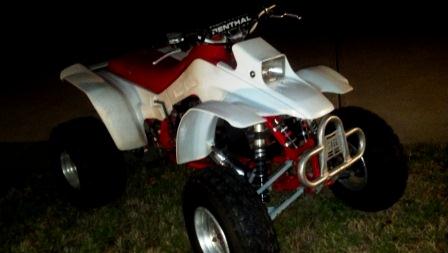

  23. I was able to dig up this picture of the old '89 250R.
