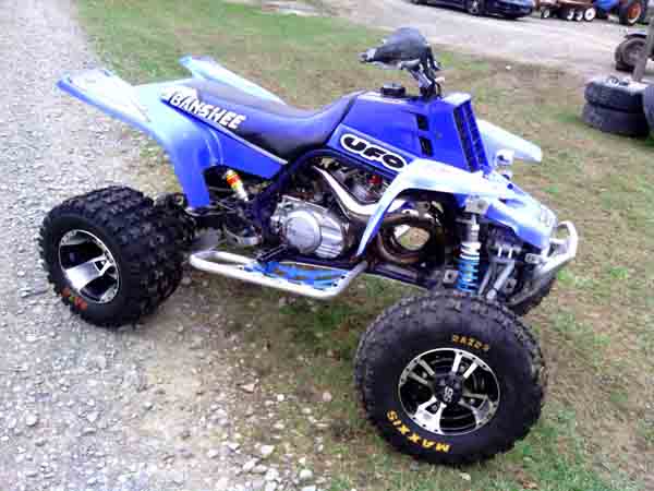

  4. Im trying to stay about $50-$55 Cheapest I can find Pro reeds are $83! that's crazy for tiny pieces of carbon fiber! lol Cheapest Power reeds are about $53 Since these reeds below are carbon fiber below would they be better to buy than the Power reeds and comparable to the Pro reeds? First are Vito's and second are TDR, the TDR says race motors tho?? http://www.ebay.com/itm/Yamaha-Banshee-Vitos-Carbon-Flex-2-stage-reed-set-/310085802345?pt=Motors_ATV_Parts_Accessories&hash=item48328dd969&vxp=mtr http://www.ebay.com/itm/Banshee-Carbon-Fiber-Reeds-Full-Modified-Motors-by-TDR-/271190275762?pt=Motors_ATV_Parts_Accessories&hash=item3f243336b2&vxp=mtr Thanks for any help! I wanna order first thing Monday morning so I can ride by next weekend
