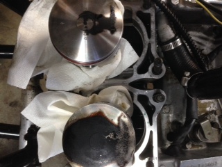

  14. Does the condition of these pistons indicate anything to you guys? I have never seen this before.
