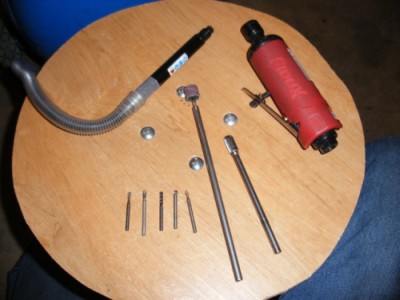

snope, i agree 100%. hey to all you "negative nancies" (that was funny snope), this year i ported my engine myself. i bought a race logic stage 3 template from snope and just followed the template ot a "t". i got some pics sent to me from another individual on here, so i had a better understanding of what needed to be done. i asked snope and some other fellows some questions and got some books, read the books, and had a very, very good understanding of what i was doing. you have to start and learn somewhere. i did just that. i took my time on the porting (11.5 hrs) and it turned out great. front end comes up without trying. :smile: i ported the engine with what's in the pics. you don't need to spend the $ to have someone else do it. i did it myself, learned something in the process, and will now for sure never have anyone else do it, cause i know i can. hey "negative nancies", with the $350 that i saved by doing my own porting, i can put towards a fresh top end (when the time comes) and it will be like i got it for free. :thumbsup:
