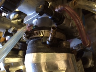

What's up guys , bought these intakes from one of the members on here , they almost what looks like a port in the billet intake for a fuel pump could be wrong just looking for some input on what you guys think

Nitrous? Is it in both?
Looks like it's actually molded in to the intake boot. Could just be a factory snomo boot or some motorcycle boot that someone just retrofitted. That wouldn't be optimal for fuel pump.

sorry for putting it on both forms just trying to get it figured out . It has them on both side ones pointing down on the opposite side so I'm hoping it'll work for running the pump the member I bought it from bought it from another member and nvr asked .

you don't have any idea what the intakes were on organally? there prob just vac lines . I don't know if fuel fuel injected bikes need a vacuum for a regulator but that could be it.  just plug them
Buy new boots. Those are crap. Pulse pumps need pressure and suction to work. Source needs to be on the piston side of the reed cage. Those are just air leaks waiting to happen. Kaboom
