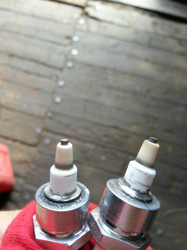

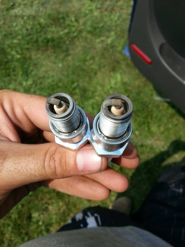

Here is the up to date plug check. I consistently ran 6.1s any 94-96mph. I changed my timing from 10* to 8* felt much better. Also i went from 2.4 at the beginning of the night then switch to 2.375 gearing didn't go any faster. Do u think my clutch maybe slipping now? Any ideas on what to do now? I still beat every one to just pass half track then they go around me. They ran from 99-103mph

1st thing would be to cut the threads off them plugs & take a picture of the fuel ring at the base of the porcelain & post it up.

I was running 90-94mph I need to be in the 98-101 range thats about what everyone else runs. If I turn back the timing will I need to regear it. Which the gearing and timing I run now it comes out awesome just the big end I need to figure out.
The data/information given shows you picked up mph by pulling the timing back to 8*. I would like to see you drop down to 6*, even though the heat mark is in the right place on the ground strap. IMO, this is the only area I would be changing, until it doesn't improve. Then you can move on to other areas, one thing at a time.
I still would like to see the plugs with the threads cut off. This may or may not be the next area to start tuning after the timing exercise is done.
