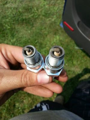

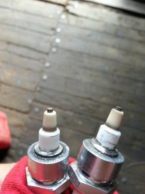

ignition timing
Joejr915
App Store. Download tap talk. Tap on tap talk icon, search banshee hq, sign in, go to this post, reply, in the reply load a photo off your phone gallery.
Is this 500 ft dirt, or actual 1/8 mile on asphalt? There are a few variables that could be making the motor just go flat up top. Timing, compression, exhaust, head/dome design.
Link to comment
Share on other sites
Fuel valve type and tank cap vent specifics please. Also billet bowls? Does it fall ob its face or just doesnt quite rev out right? Its either starving for fuel or geared a little high. Gears tires and weight info would help also
