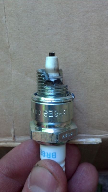

Hey guys, does this plug look OK?  That's a carboard box in the background to compare.  I did the proper plug chop method.  Just want to make sure it isn't lean before I head out.  It's a little lighter than I was imagining but, when I compared to the cardboard box, it was very close in color.  Whatcha think?

UF, my understanding is the needle is 1/4 to 3/4, with some overlap on each end of course.  I've read a ton on jetting lately - just never actually jetted anything so i'm certainly no expert.
I feel like the needle is perfect after moving it from the 4th position up to the middle to lean it out a bit.  My power in the mid range is awesome.  The top end (main) is about the same as it was before the VF4's but i am still a bit insure about my pilot jet.  Seems like it is rich and i only went from 25's to 27.5's.  I currently have them just shy of 2 turns out but, just being inexperienced and new to this bike altogether, i am having a hard time diagnosing if I am lean or rich etc.  I almost feel like I need to go back to 25's with the new airbox.   The plugs are black as night after riding for a while.  One thing to consider is that I do some trail riding that is not ideal for a banshee at all.  Like going deep into the woods on old overgrown trails and, at some times, having to make our own trail whereas I am in and out on the clutch constantly and running between idle and 1/8th throttle so maybe it makes sense that my plugs turn black
